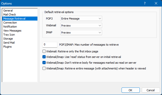

Is the problem that PP has to retrieve the messages at all or that it takes a while? That is, I'm asking if your other computers still have to retrieve the messages when you view them or, if they do, if it's much faster than what you're experiencing?
There are some default options you can look at changing, specifically:
main menu: Tools / Options / Message Retrieval
I've included a screenshot the default settings below for reference.
One option in particular may be causing PP to have to retrieve the message when you view it:
Webmail/Imap: don't retrieve body for messages marked as read on server
What this option means is that if PP sees a message that it doesn't already have, and it's already been read (as marked on the server), then PP will only retrieve the header. So when you open this message in PP, PP will have to retrieve the entire message so that you can read it. If you think this is the case (ie. the problem occurs for messages that are already marked as read), then disabling this option will help.
Retrieving the entire message is generally fast (couple seconds), but there are some reasons why it may be slow, including:
- not already connected to the server (e.g. imap is disabled)
- large message (attachments)
- the account in PP is busy doing other things
- slow internet
