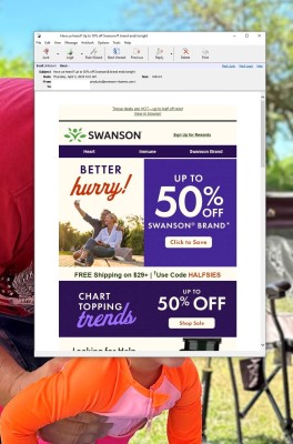

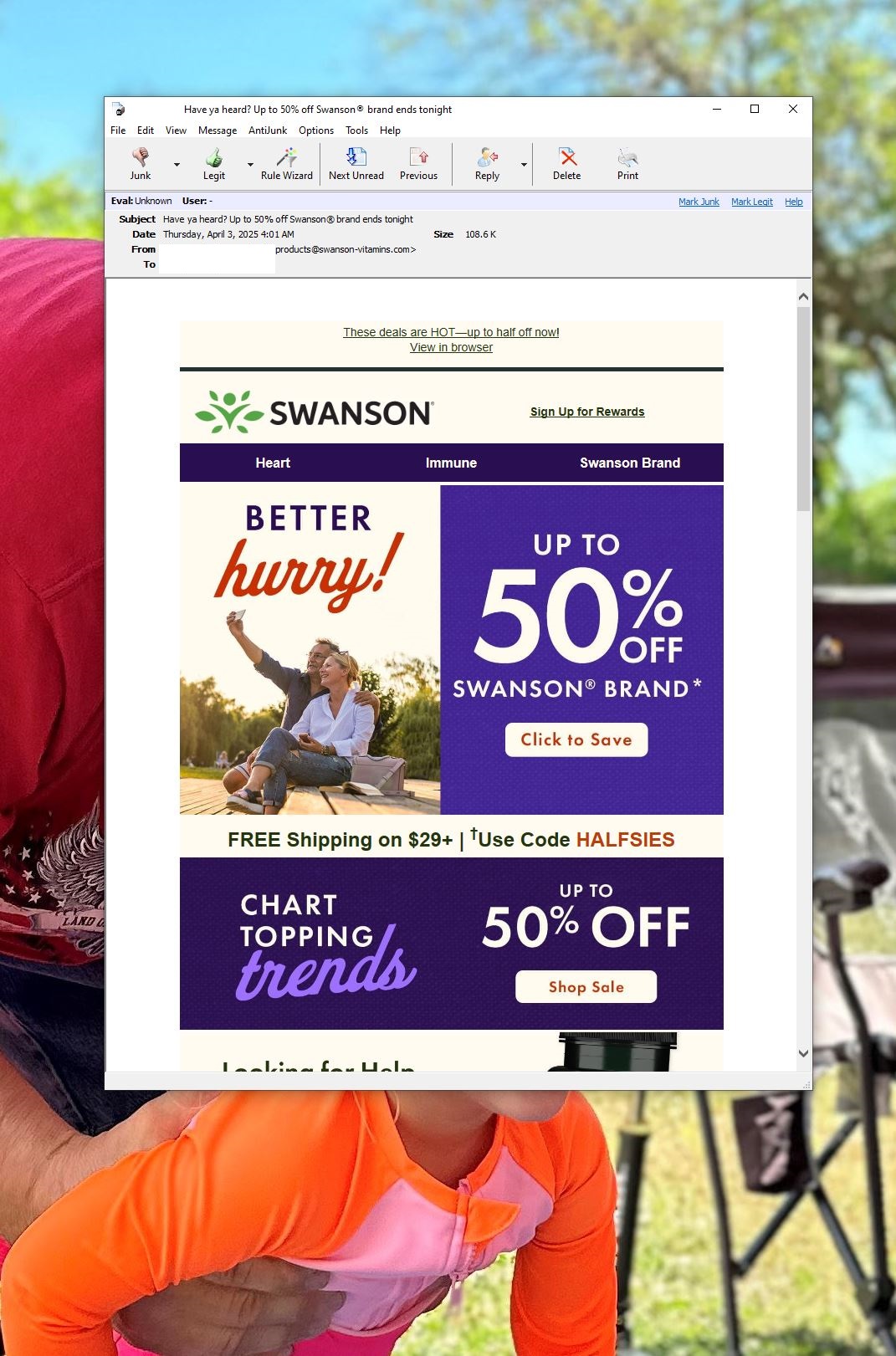

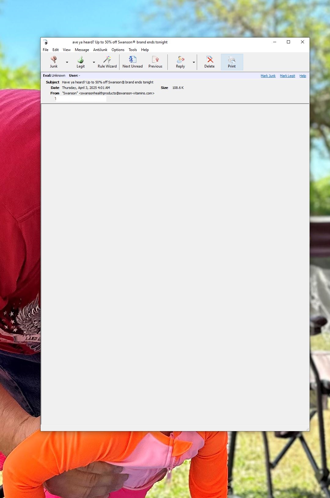

when reading email that has images, if I have the popup window large to maximized it is blank, if I drag it smaller the content then magicaly shows. How can I view in full window size? - 2 attached screenshots the one with the image showing is before dragging it a little larger and loosing everything, drag it back smaller and it returns.

Is the problem specific to that newsletter?
No, it often occurs with other email such as I get 5 or 6 daily emails from eBay with searches I have saved. Sometimes it occurs with those other times it doesnt. I have not found anything specific that always causes the issue other than I have Not had it happen with text only - it does seem to occur more often if I have 1 or 2 other windows still open that I read the email already
- Does it occur if you actually maximize the window?
Yes
- And then "fix" if you restore it to the normal size?
No
And does it matter if the "normal" size was working or not before you maximized?
No, If it was looking Ok and I maximized it goes blank then when I go back to previous size its back
- What if -- when the problem appears -- you use View/Plain text, then back to View/HTML?
I tried toggleing back and forth a few times, no difference.
I guess I should add that I do have a problem with poppeeper closing randomly from time to time. I delete the data.db on all the accounts and it works fine for a few weeks then I redo the delete - I have not noticed weather or not I have the above problem after a delete.
Yes
No
