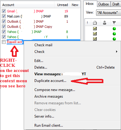

Okay try this, delete the new account that is not working then Right-Click on one of the Hotmail accounts in the accounts list that does work in the left pane of the main Pop Peeper interface window and from the context menu select "Duplicate account..." and then continue to create the new account entering only the new user specific data that applies to this new account leaving all protocol settings as they are.

I don't seem to have the option to Duplicate accounts.
Re: New Outlook account - unable to send via Webmail
Just to further clarify, then are you saying you do not have this option pointed out below in the context menu when you do a RIGHT-CLICK on your email accounts?
RIGHT-CLICK ON ACCOUNTS TO GET THIS CONTEXT MENU

no, only 4 options.
No duplicate account.png (5.61 KiB) Viewed 10241 times
My apologies, I should have made sure you have "Advanced options" enabled. :oops:
In the Pop Peeper main menu go to "Tools" > "Options" > "General" tab and click on "Advance options" to enable this feature.
Now you will have all the added functions for the RIGHT-CLICK on your accounts. =D> (so you can now try the "Duplicate account.... " option :wink:)
