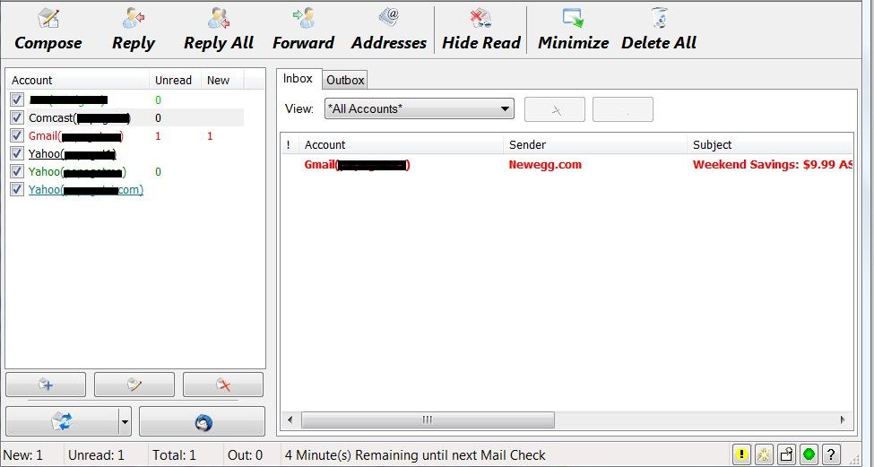

Suddenly, no connection. My password is accepted for my default Yahoo account. My other email accounts AOL and Comcast work correctly. However, I have two additional Yahoo accounts and the password is not recognized. I uninstalled and reinstall to no avail. How can I fix this? They will not accept the default accounts password. I went to Yahoo email and changed the respective email accounts passwords, but still no recognition.
See attachment for the two email that are not recognized.

pepegot1, I have removed information from your attached image for security and privacy reasons. It is always advisable to not post this kind of personal information in the forum.
Also whenever issues such as this occur it is always a good idea to provide us with the "error" information in these cases because it gives us additional data regarding the problem that is helpful. I also noticed that it appears that your POP Peeper is not up to date at some level which the "error" information will also provide to us more specificity about as well.
So would you please click on the yellow exclamation you see in the lower corner of the POP Peeper interface (see image below):
Provide Error info please.png (11.09 KiB) Viewed 9137 times
and then click on the "Copy" button in the "Error" window that pops-up and then in a reply in this topic, right-click in your post and select "paste" in your reply to provide us with the additional "error" information we need to look into your problem further.

I am running ver. 3.8.1 There is no icon when the yellow icon is pressed.
Need I upgrade to ver 4?
Re: Email recognition problem
pepegot1 wrote:I am running ver. 3.8.1 There is no icon when the yellow icon is pressed.
If you have the yellow exclamation icon dislayed as illustrated in the lower right corner of your POP Peeper window (as illustrated in your posted screen-shot) then doing a left-click on it should produce another Error window with options that include a "copy" button where you can do what I had suggested.
In any case keep this in mind because this is what we recommend you do when these type of errors occur.
As to upgrading to v4, yes this would be highly recommended because there are specific aspects of v3 that are no longer supported which could impact the performance of POP Peeper depending upon how your accounts are setup (i.e. Webmail is no longer supported in the event this is what you are using). The requested error information would have provided us with this information.
If you elect to upgrade to the current v4 then please refer to this announcement page: POP Peeper v4.2 released.
Otherwise as an alternative, you could also try changing your Yahoo accounts to IMAP to see if this helps with your problem.
In any event, the best alternative would be to upgrade to the latest POP Peeper version 4 :wink: (also keep in mind while there are some options to make version 4 look similar to the interface you now have there will be changes to how POP Peeper will look using v4 compared to what you have now). In regards to this you might want to take a look at this page POP Peeper User Interface changes between v3 and v4 and then there is this page comparing POP Peeper: Email Notification where if you scroll down the page you will find a POP Peeper Comparison chart that you may find helpful.
