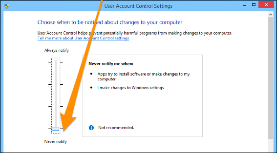

Just to clarify as to what you've described here by saying "... I'm disabling it", that is UAC presumably.
So are you saying that you've actually changed your UAC setting(s) for your computer(s) using WIN8 to "Never notify", as you see in the image below?
If so, just a word of warning, for security reasons this is not recommended. When set to "Never notify" this will allow any executable file to run on your computer and make changes of any kind without your knowing anything about it.
If you haven't done this (that is, changed the setting to what you see above) then UAC is not "disabled" and should work as expected, that is provide warnings that can help prevent unauthorized changes to your computer.
If on the other hand what your actually doing is disabling UAC from prompting for credentials to install applications by running the Windows accessory "secpol.msc" to "disable" UAC at the time of the install (which is a relatively complicated procedure, especially in WIN8) then that's different and would of course only apply to the specific install. (if this is not what your doing then disregard)
BOTTOM LINE: That all said, as to why what you've done as described by Jeff has solved your issue, this is because UAC also impacts "write protection" settings specific to the "directory path" that as I understand it is totally independent of the UAC "warnings" settings (described above) in any case which is why what you did was necessary to resolve your specific issue discussed here in this topic.
