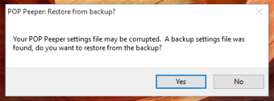

I've had PP for for a long time and it's worked flawlessly, I just upgraded to Pro/Plus and now every time I start my computer I get this pop-up message...
"Your settings file may be corrupted. A backup settings file was found, do you want to restore from the backup?"

If this message involves Pop Peeper it should read as follows: "Your POP Peeper settings file may be corrupted. A backup settings file was found, do you want to restore from the backup?"
Can you please provide a screen shot of the error? (for help doing this: How to take a screenshot & attach/insert it into your post)

Just in case, here's the notification.

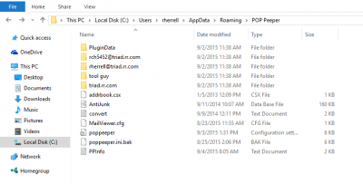

All I have is the .ini.bak file, is this the problem, i.e. no seperate .ini file? I searched for poppeeper.ini but all it returned was the .ini.bak file.
Re: Corrupted settings file notification
The file we're after is the file immediately above the poppeeper.ini.bak file. ie. its name is "poppeeper" and the type is "Configuration settings"
However, based on the fact that both file sizes are 6K, it's possible that the backup file doesn't have any accounts in it either.
I apologize for the problem, but at this point it would probably be easier just to setup those accounts again. It looks like you only have 4 accounts, which is certainly not as bad as it could be. If you want me to investigate it a little more before you resort to that, send me your poppeeper.ini.bak file and I'll see if it has any of your account information in it. Email it as an attachment to (support at esumsoft dot com) -- it may contain some personal information, which I will ignore, so do not post it on this public forum.
rherrell wrote: All I have is the .ini.bak file, is this the problem, i.e. no seperate .ini file? I searched for poppeeper.ini but all it returned was the .ini.bak file.
Have you done a right-click on the file named "poppeeper" with file type "Configuration sett..." ("popeeper" file displayed in your screenshot w/ modified date of 9/3/15 directly above your "popeeper.ini.bak" file) and selected "Properties" to make sure that "Read-only" toward the bottom is NOT enabled, if the "Read-only is checked then uncheck it and click "OK". (since you have a total of only 4 accounts then it's possible that the small 6KB file size may actually be entirely appropriate).
