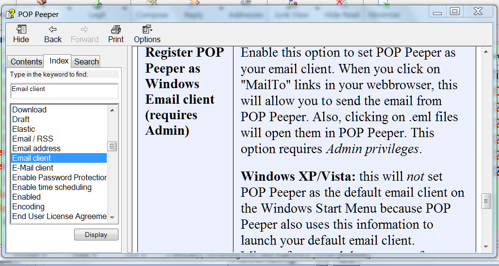

Re: outlook email client suddenly appears when composing
Hi Norm,
Jeff & other members of the Esumsoft Team should be stopping by this afternoon and can provide more info on the issue you're having. In the interim, if you open PP > {HELP] > [CONTENTS], scroll down the list of topics shown on the left side of the window that opens, and click on "Email client", then click the [DISPLAY] button at the bottom, information will appear in the right side of the window.
Scroll about two-thirds down the page, and you will see information as shown in the screenshot below, which deals with registering PP as your email client, along with some issues that can occur & how to resolve them.
Using PP as your email client
Please post back if you are still experiencing problems after trying the instructions given in the Help File article.

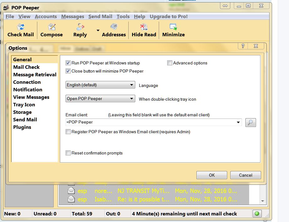

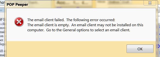

Here's a follow up with the error message I get with PP set as default email client.

When I had asked what you changed, I was actually referring to this comment:
bbqbrisket wrote:I was able to find how to change email client to PP but now the whole program just freezes
The screenshots help, now I understand that problem.
The email client that you're setting there is for an external email client (e.g. Thunderbird, Outlook, etc.). Setting it to "POP Peeper" won't have any beneficial effect. That being said, it made me nervous when I realized that's what you meant and that that's what caused it to freeze so I tried it myself -- I did not have the same behavior that you described, but I'm still curious to know what action you performed that caused PP to freeze at that point (ie. did you press the "email client" button, did you try to compose a new message, etc)?
I do recommend removing "=POP Peeper" as your email client -- just set that value to blank or select a different email client. Since you're getting the "email client is empty" error, I presume that you don't have another email client installed. This is not unusual; and in that case, you should just leave the "email client" field blank.
Posts: 9256
One last thing, as I just re-read your last post -- I think that you're referring to the "email client" as the window that opens when you compose email. Those two things are not necessarily the same. As I mentioned in my previous post, the "email client" should be thought of as an external email client (Thunderbird, Outlook) which POP Peeper can launch in certain situations. That email client *can* be used to compose your email, but I don't think that's what you're asking about. I think that you want to use POP Peeper for your composition, for which the previous instructions should fit the bill.
