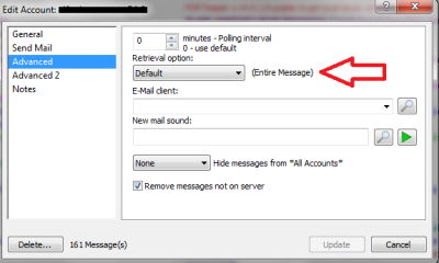

If the settings you have checked that are set to "Entire Message" are the "Tools" > "Options", "Message Retrieval" settings then also edit the specific problematic account (right-click "Edit account..."), select the "Advanced" tab. and make sure you see the following setting below (pointed out):
Note: If you do not see the "Advanced" tab in the account edit interface window (as illustrated above) then go to "Tools" > "Options" and in the "General" tab make sure that "Advanced options" is enabled (check the box, upper right of interface window).

I've verified mine says "Default (Entire Message)" for the problematic account. I even tried setting that one account to "Entire Message" instead of "Default", but no change in behavior.
