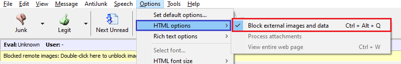

The state of the menu option Block external images and data is initially checked (i.e. it's successfully blocking remote images). Yes, I could click the yellow banner that says "Blocked remote images", but I'm hoping to avoid using the mouse.
Having assigned various keyboard shortcuts to the menu option Block external images and data, none of them work, in the sequence described above.
Curiously, step #2 DOES work via its keyboard shortcut if you first reveal the menu options that are children of HTML options.. (the red area in the screenshot) by mousing over it (i.e. the blue area).
Thanks for your help!

Aha! I understand now, sorry for the confusion. Your last comment summed it up well; but basically, when viewing as HTML, the keyboard shortcut for "block data" (as well as the other html options in that submenu) would not work until the submenu was opened.
This has been fixed for v5. Thanks for following up.
