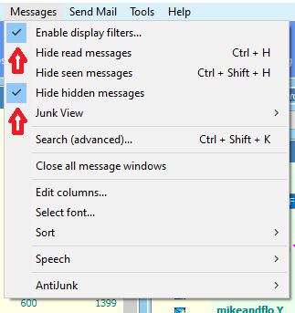

If your want to see all possible messages (including "Junk" messages) you could try this (selecting "messages" from the main PP menu):
See all messages.png (9.48 KiB) Viewed 4239 times
-- remove the check marks (temporarily) to see all messages -- which in this case you will presumably find the message(s) that your are expecting to see that are perhaps missing from your In-box. Be sure and return to what you had before by adding the check marks back as they were previously when you are done using this option (this option, disabling "Enable display filters...", is intended to be a "temporary" solution).
Let us know if this helps in any way and if not please explain in more detail - what it is that you are expecting to find in your PP In-box that is apparently not there and why you feel it should be in your PP In-box.

Junk mail icon is on--by that I mean the icon in the tray is showing RED and hovering over it says there is one junk mail message.
Excuse me for saying "view" instead of "show". Apparently you did know what I meant.
My goal was to find what and where this mysterious message is.
There were a few messages that were "hidden" although I don't know why or how that happened. Apparently it thought one of these was junk, although from a sender on the whitelist.

1) The only filter that's included by default that would hide the message is the "BCC" rule; but this will also mark the message as read, which means it wouldn't cause the red-envelope status in the tray icon. If it happens again, you may want to see which filters triggered on the message (there are various ways, but one is to right-click on the message and select AntiJunk -> Show evaluation) and that would help narrow down which filters to look at to see if they are set to hide the message. If you have an action to "hide" a message, it's probably a good idea to "mark read" as well to avoid this issue.
2) Besides using the "Enable display filters" method, there's another trick which may be better, but not quite as easy to remember. If you do a search for:
status:junk
it will show you all messages evaluated/marked as junk. Search always shows hidden messages and they'll appear in italics.
Unfortunately, you can only search for one "status" value, so you cannot search for "status:junk status:unread" -- maybe someday, though. (technical note: searching for both statuses will use the final one and ignore any previous ones, so the above example would result in all unread messages regardless if they're junk or legit)
