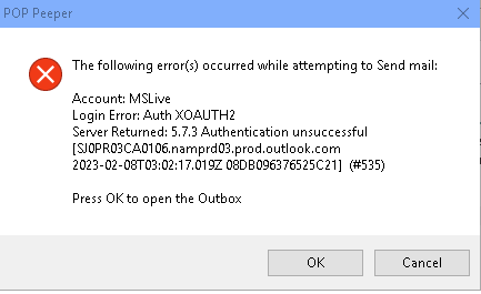

I have a MS live.com acct which was working fine with Oauth2.
Yesterday I started receiving the attached error, after which the messages do go thru.
Very weird.

Use the password method instead of Oauth2 -- see the details here:
https://www.esumsoft.com/news/outlook-s ... th2-error/

Looks like MS fixed it -- sent email to myself and got thru, no error.

I sent test messages to all my accts and they got thru without the error.
I sent a message to an external acct and it went thru without the error.
That's when I thought MS fixed it.
But then I sent to a 2nd external acct and got the error, then seems to have gotten thru.
So it's not fixed, but the error is intermittent and yet msgs seem to go thru.
Weird.

For the record I have not had any tests that end up getting sent as well. And in every case when attempting to send a message by way of an MS account messages continue to remain in the POP Peeper Outbox (in a state of error) as one would expect in the event of a "send" error.
To go over what transpires in my case, when attempting to send a message using Outlook.com:
1) The (Oauth2 type) Error occurs each time when attempting to Send a message using MS email for multiple tests.
2) All messages with the "Send" error continue to remain in the POP Peeper Outbox (in a state of error).
3) None of the messages (tested over a period of more than 2 hours) have at any time been sent (to the recipient account) as a result of initially sending the message or (retries) as a result of either a manual "Check Mail" and/or a scheduled (12 minute polling interval) "Mail Check" (ultimately requiring my deletion of the test messages from the Outbox). (hence, as one would expect in the event of an error, the messages [w/ errors] continue remain in the PP Outbox and do not at any time reach the recipient accounts "Sent Folder").
To be clear, result 2 and result 3 (above) are in general what would be the expectation in the event of a "Send" error occurring in POP Peeper. I do not get (what I would call the "weird" outcome) where a message actually leaves the POP Peeper Outbox and ends up getting sent to the recipient account in spite of a POP Peeper "Send" error occurring).

Yes, that's what I called weird.
At the time of my reporting this,
1. I would get the error,
2. the msg would remain stuck in outbox
3. after a few seconds it would disappear.
When I checked the Sent folder, the messages were there.
I also tested this by CCing the messages to me and I received them.
But today they get stuck in the Outbox and DO NOT get sent -- the weirdness went away, but the error
remains.
It's unbelievable that MS has not fixed this in such a long time, but hey -- that's monopolies for you.

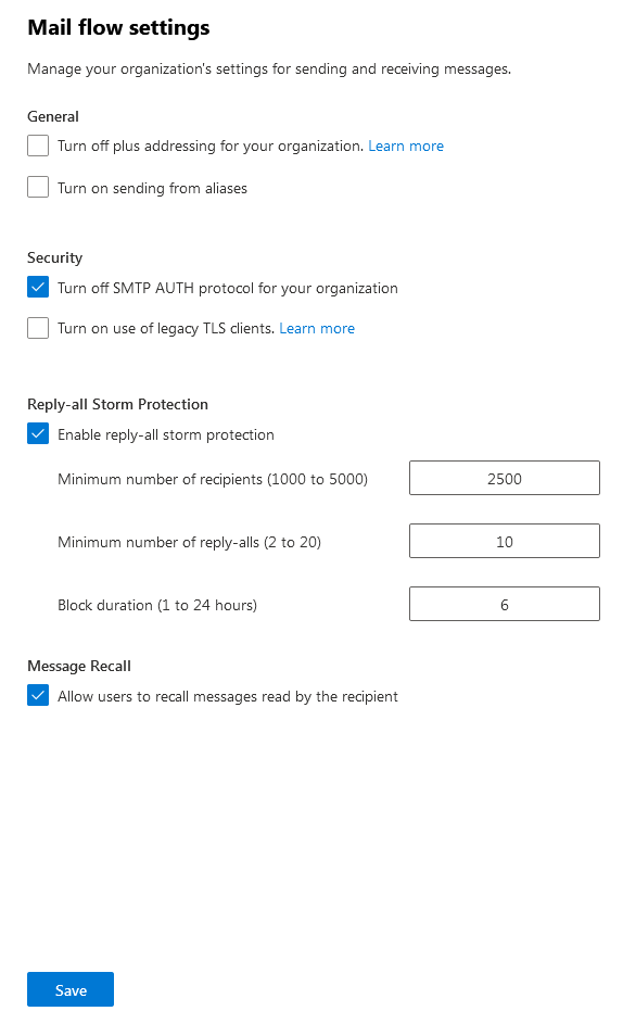

The following info won't help for basic or free outlook maiboxes, but for Exchange mailboxes, there may be a fix in there.
(I can't find a "Live SDK compatibility" checkbox either.) The most relevant settings I can find, in the Exchange Admin Center, are the security checkboxes in

The first link refers to old TLS methods that current versions of POP Peeper don't use. The current TLS libraries that PP uses support TLS v1.3. ftr, if you want to see what TLS version PP is using for an account (which has connected at least once to the server since PP started), you can right-click on the account and select "Server Info" -- TLS version is at the very bottom. If you don't see "server info", enable "Advanced options" under main menu: Tools / Options / General.
The second link is for disabling standard SMTP Auth -- this is not Oauth2 (smtp auth is the standard method that most smtp servers use). Free outlook accounts have not disabled standard smtp auth, which is why disabling Oauth2 works.
