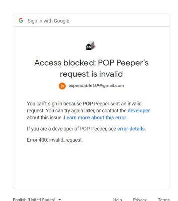

OK - so up comes the ''enable oauth2 window'. Well THAT works, I've got one on that already....
NOPE!
'Access blocked: POP Peeper’s request is invalid
xxxxxxxxxxx@gmail.com
You can’t sign in because POP Peeper sent an invalid request. You can try again later, or contact the developer about this issue. Learn more about this error If you are a developer of POP Peeper, see error details.
Error 400: invalid_request
And the error details were:
The out-of-band (OOB) flow has been blocked in order to keep users secure. Follow the Out-of-Band (OOB) flow migration guide linked in the developer docs below to migrate your app to an alternative method.
Request details: redirect_uri=urn:ietf:wg:oauth:2.0:oob
The 'details' tab below that sends you here: https://developers.google.com/identity/ ... -migration

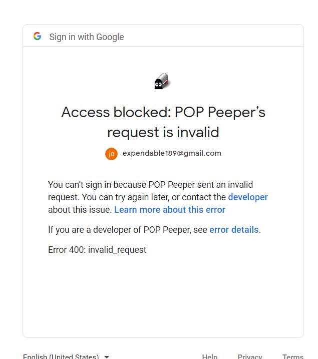

OK maybe I cocked it up - I'll do another one. Same thing - and note, using exactly the same entries as for the one I already have.
Right. I'll do a Gmail one - those work! Nope. 'Login error, authentication failed, invalid credentials failure'.
NOPE!

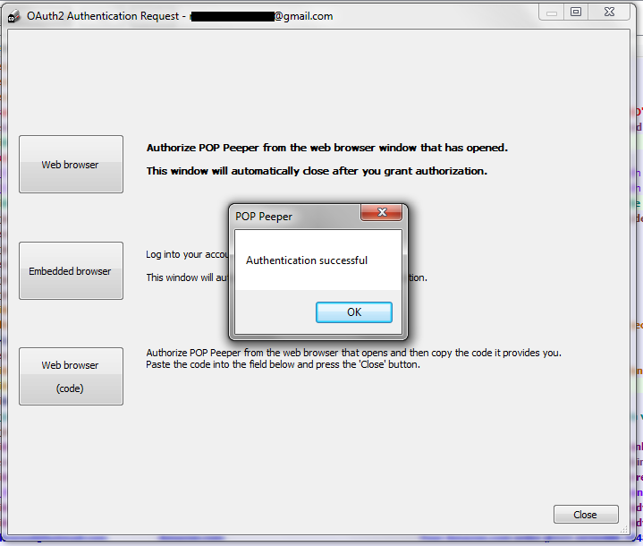

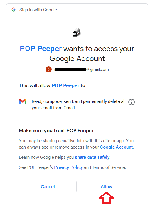

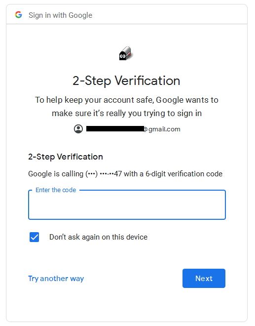

Re: 'Failed to verify after EHLO'
For Gmail, see this FAQ: https://www.esumsoft.com/pop-peeper/faq/?q=GmailOauth
This is a more succinct post of the article originally posted here: https://www.esumsoft.com/news/notice-gm ... peeper-v4/
Likely, your existing accounts continue to work because they haven't needed to re-authenticate Oauth2, but it's probably just a matter of time.

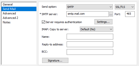

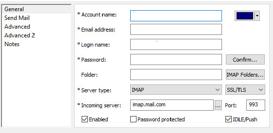

If using mail.com FREE then it is my understanding that these settings are what will work assuming no security interference is present (works for me) - their a bit picky about their free service
Incoming: Outgoing: If you're not using these settings, try this and if necessary with AVG Email Shield disabled (just for testing purposes).

In regards to Gmail on Windows 7 - all of my Gmail accounts work seamlessly in POP Peeper on my Windows 7 machine (but then I'm not using Avast/AVG for my AV security). With that in mind, there is no reason then that Gmail should not work for you (in POP Peeper) on Windows 7 as well (that is, by removing the AV interference in your case
Well that's what I thought too. But it didn't. You saw the gmail message re 'out of band'.....

As mentioned, I'm using FREE MAIL.COM - these are the settings that work for a FREE account.

The gmail ones now work fine, you don't need to provide a phone number to get new ones, so I'm OK now, can manage without the others as I can at least receive emails. Just change the sender to reply.
To be clear -- did you read the article I posted to earlier, it gives directions on what you need to get Gmail to work on Win7:
And, as mjs mentioned, it's mail.com that wants the money for IMAP; mail.com requires a premium service for IMAP access:

Sorry guys, but that did not work.
I did a new gmail account, set it up, no problem.
Signed into pp as explained, no problem.
Clicked to use oath2, got message would go to web browser, clicked 'web browser' as directed, and got
this: Also:
Related developer documentation
related docs were here:
And here - https://support.google.com/accounts/answer/12379384
ie. what I got before. Note this is a NEW gmail account. I am getting the impression that existing accounts may still work.
I have one older one, which still works at the moment with PP, but am not about to mess with it to test it!
But I did try above with AVG off - it made no difference.
My first thought is there may be an issue with Windows 7....
So to test for this, I just now successfully added a new Gmail account to POP Peeper on Windows 7 (a few encountered steps during the process illustrated below).
I would suggest you try the process without AVG interference.... (following the proper steps you should get the posted results below, at least I did...).
1) Make sure you exit POP Peeper (so that you can start POP Peeper running with elevated/admin privileges in order to authenticate a Gmail account).
2) Now that POP Peeper is not running - start POP Peeper running as Admin - then edit the relevant account to authorize POP Peeper.
3) When authorizing POP Peeper you should get the following dialogs (following the expected POP Peeper prompts to get authorization started):
A) 2-step verification code dialog: B) Allow POP Peeper access to Google: C) Authentication successfully completed: The added GMail account to POP Peeper works seamlessly on Windows 7 (tested both incoming/outgoing messages).
Remember to exit/restart POP Peeper the 'normal' way (elevated privileges are no longer necessary once authentication has been completed).
Just to confirm:
You must have POP Peeper v5+ (v5.4.1 at the time of this writing). You've probably already mentioned what version you're using somewhere in this thread, but it's long and I didn't see/find it with a quick check.
Also, I looked through the PP release notes and there is a relevant change that has occurred AFTER v5.4.1 (meaning, you do not have this fix; well, probably not):
- Fix: Oauth2: On older OS's (win7), POP Peeper would fallback to a now-unsupported method for Gmail because Win7 does not support the server method required by Gmail (unless POP Peeper is run as admin); a prompt now shows suggesting that an "app password" should be used instead
HOWEVER, that "fallback" will only occur if you didn't run POP Peeper as Admin. If you're getting a message about the "OOB flow", then that means that POP Peeper is not using the correct "flow" and so I think mjs is correct -- perhaps you didn't exit POP Peeper before trying to run it as Admin (doing that would result in POP Peeper just opening the already-running one, and would not be running as admin).
As far as mjs' screenshots, personally I never* see the "2-step verification" page -- that should only occur if you haven't logged in before with the webbrowser that's being used. Although, if you haven't logged in before, I'd expect you to have to login with username/password before the 2-step verification but mjs didn't mention that...
Maybe if you haven't signed in with that browser in a really long time. Regardless, the sequence is correct after that, it's just the initial screens may differ based on your browser's cookies and whatever security Google forces upon you.
* - Just to make sure, I just re-Oauth2'd my main gmail account and it started on the screen represented by mjs's 2nd screenshot. I have 2-step verification enabled on that account. They have my cell# and an alternate email address (and this email address is connected to my Android cell phone). I have many other gmail accounts (which may or may not have 2-step enabled) and I just don't remember in recent memory ever needing to do anything but grant access. So I dunno... But then, mjs is known to have these kinds of weird issues
