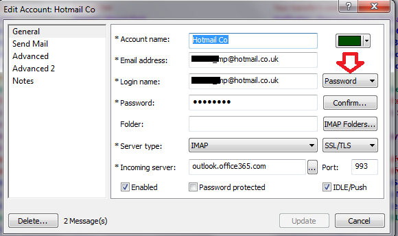

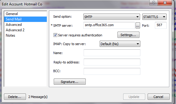

I am getting this message whenever I try and send a hotmail email through PP.
I can receive emails, I can send via non-hotmail accounts through Poppeeper, and I can send using my hotmail accounts direct through Outlook.
I am using v 5.4.1.0, and all other modules are showing as updated.
Send option is SMTP; SMPT server is smtp.office365.com; server requires authorisation is ticked.
All these accounts were working fine until earlier today. Help please!

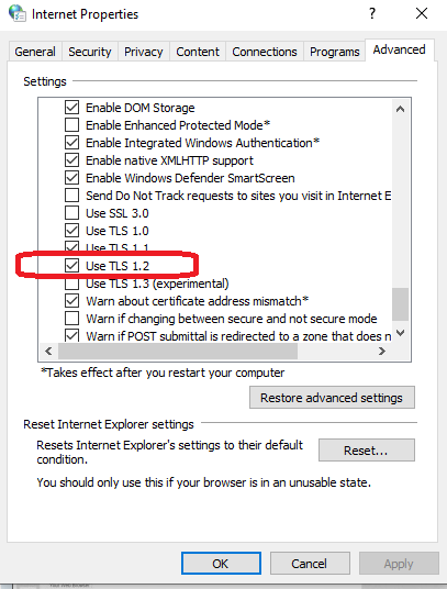

It appears you are using Windows 7 - POP Peeper v5 (and probably v4) supports TLS v1.2 (for POP3/IMAP). It is my understanding that TLS 1.2 is not enabled by default in Windows 7, so in order to set Oauth2 in your POP Peeper account(s) you may need to make sure your Windows does have TLS 1.2 enabled: as discussed in the link above.
If your issues persist further, then you might want to try the protocol settings that are working for me with my Hotmail accounts regarding SMTP (to see if this might get you better results for your Outgoing "Send Mail" Server): Btw, on a side note, my incoming Server ("General" tab) is set to the following: imap.outlook.com using SSL/TLS, Port 993.

1) Have checked and TLS 1.2 is ticked. Plus I have had no problems using Oauth2.

My settings are:
Incoming:
IMAP SSL/TLS
outlook.office365.com
Port 993
This works fine.
Outgoing:
SMTP STARTTLS
smtp-mail.outlook.com
Port 587
This is what was working. I have tried the SSL/TLS option, but that does makes no difference.

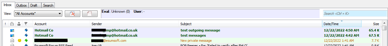

I'll be sending you a PM of settings that worked for me (screen-shots) to send and receive messages using your account.
PM sent as of now.
PM sent as of now.
Reason: Updated to add last comment line

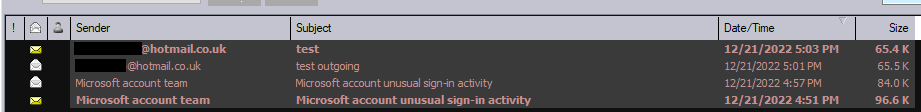

Re: 'Failed to verify after EHLO'
You should see these four messages (date/time stamped as of the time when they were tested) in your account (that I added to my POP Peeper app), including my two test messages and the typical (2) MS messages that would be expected under these circumstances:
Well for anyone following this at some point...... none of that worked.
I did get the messages sent to the account as usual... but unable to send out from here.
Which seems to narrow the problem down to a combination of using a hotmail.co.uk address with Windows 7.

OK, I'm now on Windows 7 and added your account (w/out changing any settings from the default settings POP Peeper used) and was able to both send/receive using your "hotmail.co.uk" account without any issues of any kind.
Screen-shots:
1) Messages in PP Inbox (you should be able to see these same messages on your end in your account as well): 2) Please take a look at these settings.
2a) Incoming: (see comments below regarding the "Password" option pointed out in screen-shot)
2b) Outgoing: For 2a - I am using the "Password" option because I cannot authenticate your account myself because it requires a code sent to an alternate email account of yours that I do not have access to.
So all I did was to not authenticate and use the "Password" option (pointed out in the screen-shot above) which requires your password be entered in the Password setting (directly across from "Login name" in the Incoming settings).
Make sure your settings are the same as mine.
You have posted in this topic above that you do have "Use TLS 1.2" enabled - so I can't think of anything else other than to confirm the settings in the above screen-shots.
