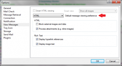

When you say quote: "I have checked the boxes to have messages display in HTML."
So then this means that you've set the arrowed setting as you see in the image below (setting at "Tools" > "Options" > "View Messages" tab > "Default message viewing preference" set to "HTML"):
Default Message Viewing Preference setting

If you still having the same issue then in regards to option #1 above: Instead of closing/re-opening the message, try switching to a different view and then back to the original, e.g. assuming it's HTML to start with, switch to plain text and then back to HTML to see if this makes a difference with the problem displaying HTML messages (not intended as a solution but just to see what happens).
Also for PP Pro in regards to messages displayed in FULL HTML: Additional information regarding "Smart HTML Viewing" in the PP Pro application interface main menu: Go to "Tools" > "Options" > "View Messages" and press F1 to open the context-sensitive help.
If you're still having problems then try disabling (unchecking) "Smart HTML viewing" for now (setting at "Tools" > "Options" > "View Messages" tab > upper most option, uncheck the "Smart HTML viewing" option) leaving all other settings as they are and see if this finally helps display messages in HTML (doing this will return to how v3 performed in regards to displaying HTML in messages).

I discovered the problem. I had checked the Smart HTML Viewing box. I noticed in your reply that this box was not checked so I unchecked it and now messages display in HTML when I double click on them in the list of messages. To be honest I have no idea what Smart HTML Viewing is but assumed, incorrectly, that it had something to do with viewing the messages in HTML mode when they first open. Now that I have unchecked that box it displays messages in HTML as expected.
