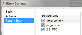

If I recall correctly (can't check to verify) whatever SPAM Reporting Services you have selected in "Tools" > "Antijunk" > "Settings" > "Report SPAM" (see below) will be used:
All 3 Services are selected in this examle.
all 3 services selected.png (12.82 KiB) Viewed 15376 times
so then for example in this case all 3 SPAM Reports will get sent (queued-up in the outbox) when the "Report Spam" button is clicked. (go to this setting to make sure whatever Services you want to send SPAM Reports to are selected)
In this example if you were to click on the "Repoort Spam" drop-down list you should then see all 3 Services selected as illustrated (this tells you what Services have been selected in the setting mentioned above):
Clicking on Report Spam drop-down list will display the selected services
Report Spam drop-down list displays all 3 Services are selected.png (6.91 KiB) Viewed 15376 times

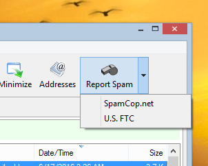

In the drop down box I see a space where a check mark could be, but neither Spamcop nor US FTC has a check mark beside it.

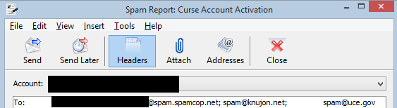

Thanks for this. After creating the new service and reporting some spam I noticed one of the email addresses had a tab space before it. When creating the service I put a ";" and a blank space after each ";" to separate the email addresses. The same thing happens when I use a "," instead of a ";". In the New Message window this is what it ends up looking like:
Removing the space after the ";" seems to fix it so there is no tab space there.

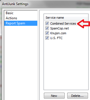

Have you moved the combined services (drag-and-drop) to the top of the list in the "Report Spam" page of the "AntiJunk" settings? (under "Tools" > "AntiJunk" > "Settings" > "Report Spam" > "Service name" list box (see image):
Combined Services at top of list. Then when the "Report Spam" button is pushed this will be the Services that are reported.
Combined Services at top of list.png (16.75 KiB) Viewed 15287 times
If this "Combined Services" is enabled in this window then there is actually no need for the others to be enabled by the way (that is if you have it setup this way and you intend to send all 3 reporting Services at the same time).
If you have this setup as illustrated above (you may have a different name for the combined Services of course) then this top multiple Services should then be the only check mark that is displayed in the "Spam Reporting" drop-down menu list after sending the Reports to these SPAM Reporting agencies. Are you saying that you do not get a check mark at that point for the Combined Services? (keep in mind the other single individual services will not get a check mark on the list at this time if they are there on the list).

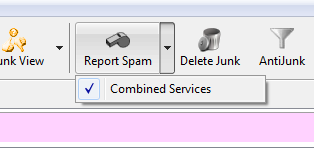

Okay, I've actually found a message I received last year that is "junk" mail that was not deleted, so I'm going to test this message with what I've got setup (which is the same as what you have now from what I can tell)
Before sending SPAM Report to Combined Services:
Combined Services not sent yet and unchecked in drop-down list.
Combined Services is not checked because it is not been sent yet.png (5.63 KiB) Viewed 15278 times
After sending SPAM Report to Combined Services:
After pressing the "Report Spam" button and sending to these services I now get a check mark placed on the drop-down list for this service.
Combined Services IS checked now after clicking the Report Spam button.png (6.91 KiB) Viewed 15278 times

Ok, I'm getting that weird tab space, too. Not sure what that's about so I'll look into it.

1) when including multiple recipients, extra characters (tab) might get included. This may have actually affected the other attributes of spam reporting, as well (e.g. body).
