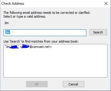

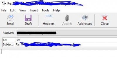

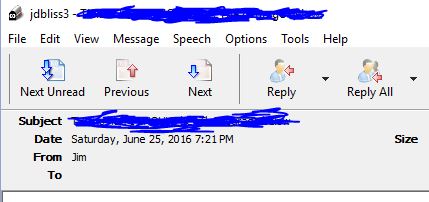

Since the last update to 4.2.0.0 I have noticed emails coming into my Yahoo account with only my friends First name and a blank To: field.
The results are when I do a reply, I get a check address window, which I never did before with this person.
When I look in yahoo online I see Jim<hisemailaddress@domain.com> in the From: field.
And I see my Last Name, First Name in the To: field.

Okay, I can confirm that some of my Yahoo accounts have messages that do indeed display a blank "To:" field.
It appears to me that if the webmail protocol is used (that is the "Server type" is set to "Yahoo") then this phenomena will occur regarding a blank "To:" field, but if either the IMAP or POP3 protocols are used then the "To:" field will not be blank (presumably POP3 as well since it should be the same as IMAP although I only tested for IMAP).
Can you please verify that in your case these Yahoo accounts with blank "To:" fields are using the "Webmail" (Yahoo) "Server type" protocol? (can be checked by doing a RIGHT-click on the account in the left account list pane of the main PP interface and selecting "Edit account..." and looking to see what the "Server type" option is set at).
If as I suspect you are using the "Webmail" protocol, that is the "Server type" is set to "Yahoo" then it would appear that if you were to change to IMAP for your "Server type" setting this will resolve the issue regarding the blank "To:" fields.

Server Type: Yahoo
Send Mail: WebMail
Pictures are included to elaborate on the Check Address window. It only allowed 3 pictures, so the 4th would show the header from Yahoo and the return path of a complete email address.
I hope that helps. Let me know if you need more.
