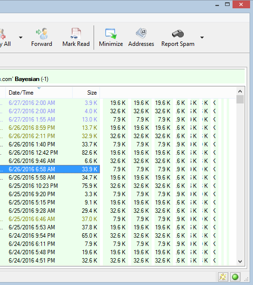

I was resizing the Subject column to make it smaller and then this happened. As the columns are moved it creates some sort of duplicate image in the white space that is left behind. Closing the PP main window and reopening it will fix it.

Confirmed and noted. Specifically, the problem seems to occur if the total column widths is larger than the window width and then you shrink it.
btw, a couple of things:
- if you double-click on the word "View" above the message list, it will force a redraw (it will actually change it to *all accounts*)
- If you edit the columns and make one of them "elastic" (e.g. subject) then that column will resize according to the window width when you resize the window

Thanks for telling me about that "elastic" feature. I didn't even notice that before. That works a whole lot better than manually adjusting the Subject column. Maybe it was elastic at one time before as a default setting and after manually adjusting that column it became fixed. I like it better as elastic.
