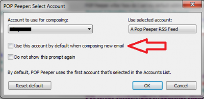

When clicking on the "Compose" button or alternatively from the Main menu selecting "Send Mail" > "Compose new message..." to compose a message you will get the interface illustrated in the screen-shot below:
Where you can optionally set the composing account as the default if you like by checking the box for the account selected from the drop-down list or optionally leave the default option unchecked and simply select from the drop-down list each time.
If you do not get this interface box when composing a message you may have checked the box to "Do not show this prompt again" and in that case if you want this interface to display again you would need to go to "Tools" > "Options" > "General" tab from the main menu and check the box "Reset confirmation prompts" and click the "OK" button to get it back.

lakrsrool,
OK, thanks.
FYI I had to reset confirmation prompts.
