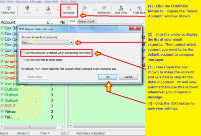

I have 6 email accounts and would like to assign a specific account as the default account to compose.
Is there a way to change it?
thanks

bbqbrisket,
To answer your inquiry, please see the image below which contains step-by-step instructions on how to accomplish what you want to do. (Click image to enlarge it)
Additional helpful information was provided by lakrsrool to another member with the same inquiry (in August) and can be found HERE.
