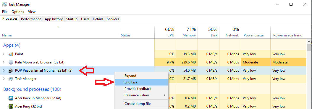

To do this in Windows Task Manager:
1) Press the "ctrl+alt+del" keys simultaneously.
2) Then select "Task Manager" from the list of options.
3) In the Task Manager you should see the POP Peeper process running (example screen-shot is what you would see using Windows 10). Note: you may need to scroll further down the list of "Background processes" to find the POP Peeper process.
4) Right-click on the POP Peeper process and select "End Task" - this will manually stop the POP Peeper process (see screen-shot below).
5) You will now be able to start POP Peeper again (without your screen-shot dialog you posted appearing).
Example screen-shot:
A Right-click on POP Peeper process line will produce a context menu in which you can then select &quot;End Task&quot; to stop the running POP Peeper process.<br />Note: a left-click on the image will enlarge the screen-shot for better viewing (the browser back-arrow will return to forum topic).
A Right-click on POP Peeper process line will produce a context menu in which you can then select "End Task" to stop the running POP Peeper process.
