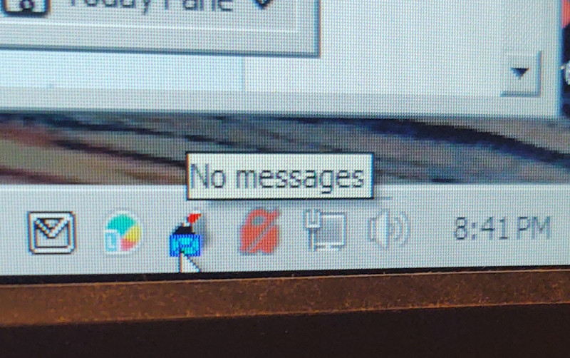

Ok, how about a screenshot or 2 of the tray icon with the mis-matched hover/tooltip text? I just want to make sure that we're on the same page as far as me understanding what the problem is. I recommend using the Windows snipping tool (or snip & sketch, whatever they call it) to capture the tooltip text, although I've been told that Win7's version of it is not as good as Win10's so ymmv.

I couldn't find a way to keep the hover text while using the snip tool, so I just took a pic. This is the condition after I've retrieved messages, but before the flag goes away. Just prior to this I double-clicked the icon, saw the "checking" eyes appear, then it reverted to this.
