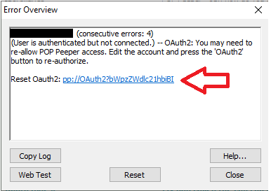

When errors occur in POP Peeper regarding Oauth2 all you should need to do is click on the link provided in the error to take you through the process of resetting POP Peeper authorization for the account(s) with this specific error (see screen-shot below - the rendering of the error may appear a little different than this example)
Click on the link to reset Oauth2 for the account with the error
Reset Oauth2.png (7.67 KiB) Viewed 5082 times

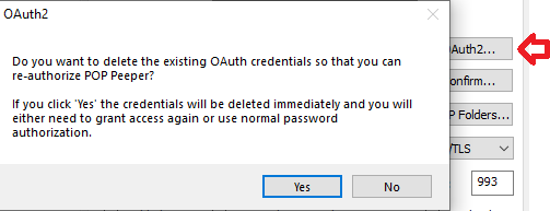

You can always at any time manually reset authorization for any POP Peeper email account by editing the account and then click on the Oauth2 button to follow through with the steps to do so (see screen-shot below which is 1st step of procedure in the account edit window)
Click on the "OAuth2" button to re-authorize the account
re-authorize PP.png (8.09 KiB) Viewed 5082 times
