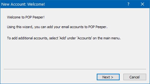

Ok, another odd problem has popped up.
At boot today, this window popped up:
It's like the program does not remember any of it's settings.
I suspected the .ini file so I deleted it and copied in the original that had always worked. Same result.
The .ini path points to the roaming directory, and it's not read only.
When I take PopPeeper off my forced and restricted program list in Sandboxie, it starts fine and has my accounts in it like before.
This behavior never happened before today even with those sandbox settings? Any ideas?
Re: PopPeeper 5.2.2 will not start
I don't have any experience with sandboxie, so I'm afraid I can't provide much insight. My best guess would be that when you first start PP, that the folder structure hasn't been initialized yet by sandboxie, so the appdata folder is invalid?
Try using sandboxie again, and if you get the "setup wizard" again, immediately KILL the poppeeper.exe process (don't continue, as this could overwrite the ini file), wait a minute or so, and then try starting PP again.
