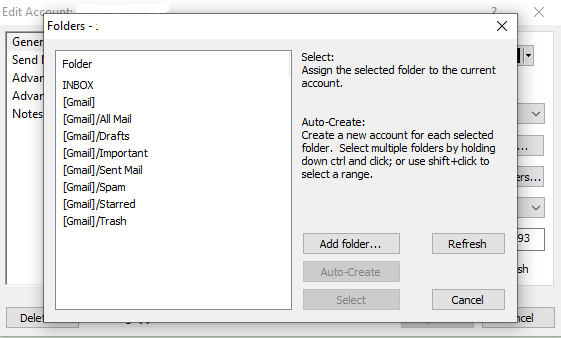

When you click on the IMAP Folders button you should get this Interface (automatically populated w/ the accounts folders as illustrated in the screen-shot):
My results when clicking on the "IMAP Folders" button in the Account "Edit" Interface
I'm not sure why your getting these errors. This is what I get (screen-shot above) after clicking on the "IMAP Folders" button - I would suggest you wait for Jeff to look over this later today.
