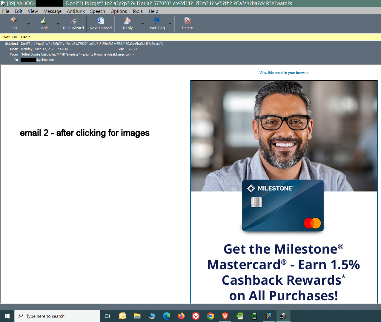

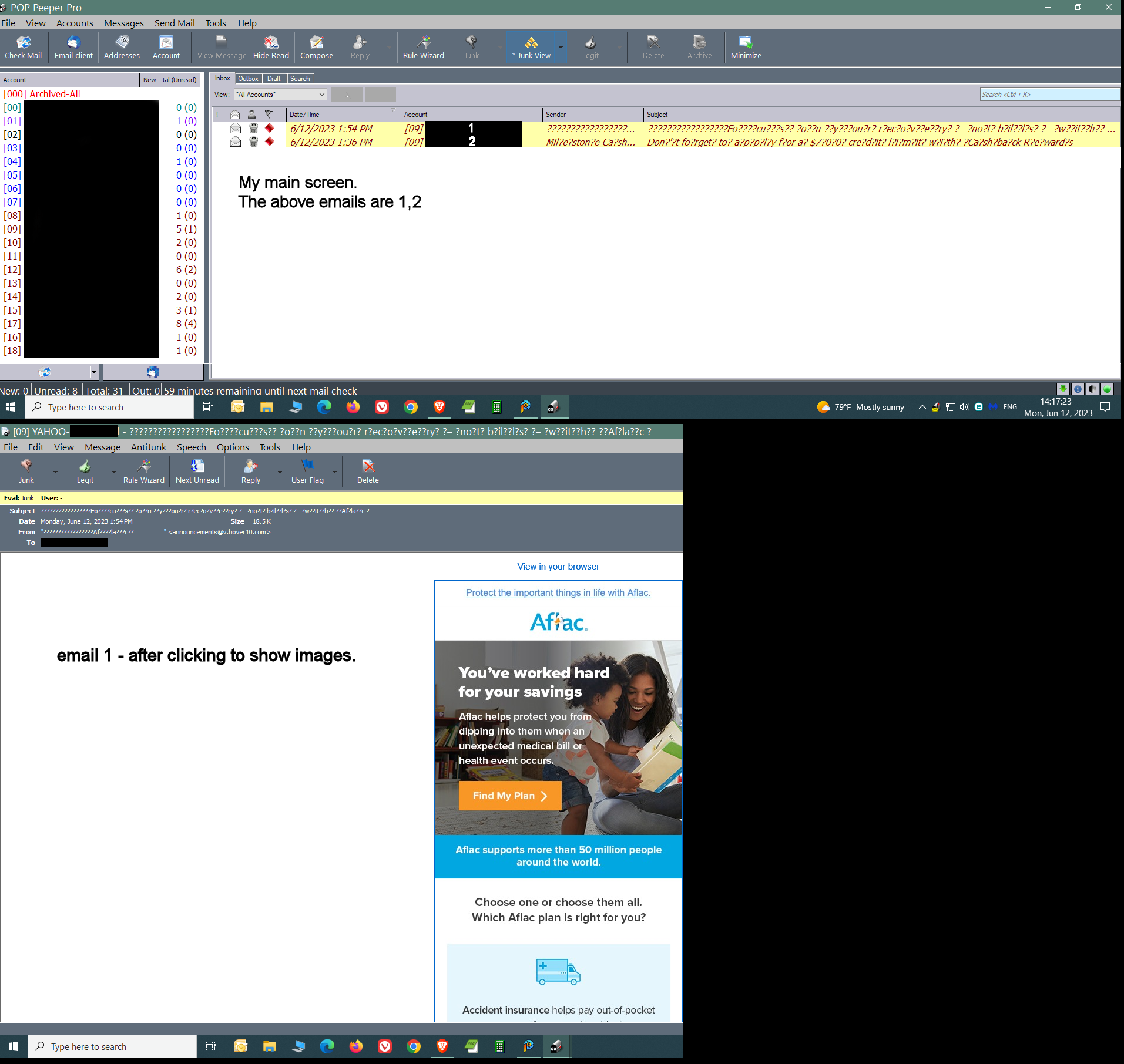

I've been using PP for a very long time, first by donation, then Pro. I'm looking for an explanation. Over the past couple of years, more an more email come with unreadable characters as follows. Most I've been able to have go to junk mail. Here are a few example.
1
Subject: ???????????Is? yo?ur? i?ns?ura?nc?e p?ol?ic?y w?o?r?ki?ng? ?as? ha??rd ??as? ?yo?u? ?????
From: "???????????Af?lac? "<store@news.exposeii.com>
The encoding for this one is utf-8. When I double click for images, the mail shows up ok.
2
Subject: ?????????????????Fo????cu???s?? ?o??n ??y???ou?r? r?ec?o?v??e??ry? ?– ?no?t? b?il??l?s? ?– ?w??it??h?? ??Af?la??c ?
From: "?????????????????Af????la???c??  "<announcements@v.hover10.com>
Also utf-8.

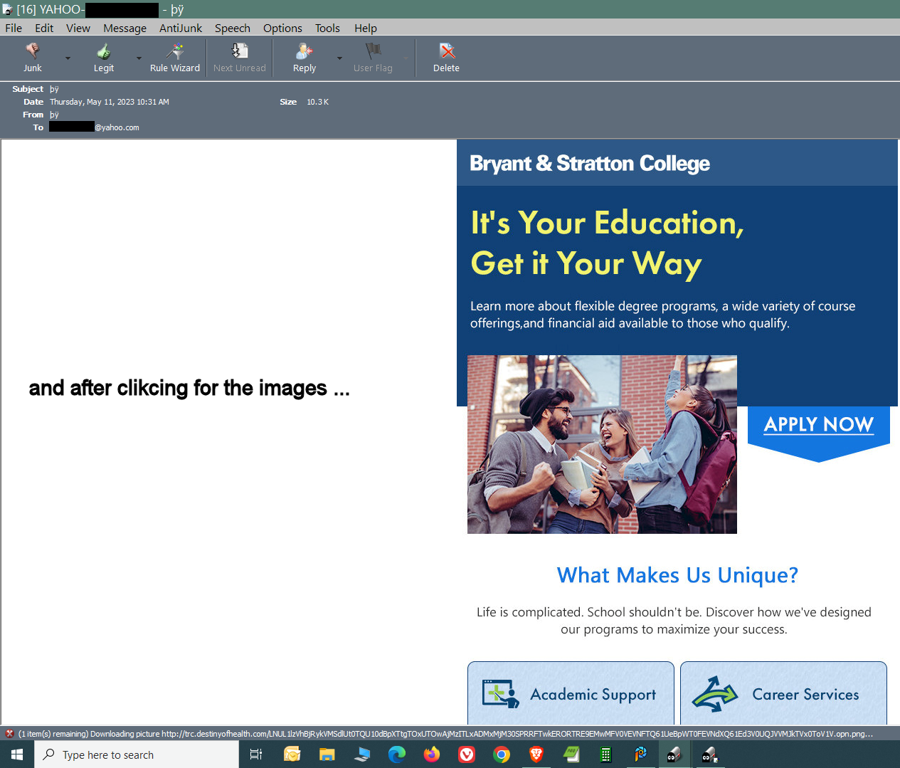

3
Subject: þÿ
From: þÿ (no address so I can't blacklist it.)
(Also encoding show utf-8.)
I'm just trying to figure out what all the weird characters mean. I used to be able to fly through what I wanted to make as junk mail, or blacklist. Now, I'm not ture if some of this is legitimate, but unreadable header for some reason. I hope someone can help me understand. The þÿ one seems too suspicious without an address to blacklist. I'm not much for understanding irregularities. I just read and try to follow directions. But now, I need a better explanation than I can give myself. Thank you.

These messages presumably contain "unicode" of which PP does not support (unicode) at this time (thus, in this case, is currently "unreadable" just as you have suggested). To my knowledge, "unicode" support is currently underway (and I might add, so far, successfully tested) to be included in the PP version 6 release. Rest assured, "unicode" will be readable when it is supported. (I will occasionally get similar results that you are getting myself. Perhaps, in some cases, spammers may indeed exploit this situation to avoid SPAM filters.)
Jeff will likely have more details to add to this topic.
Re: Weird characters; need help understand...
To provide more details (as I understand it) - let's just discuss the "?" as you see it (to keep it simple).
My understanding is that (Jeff will thankfully correct me if I'm off here :-k), as far what goes on (in the event "unicode" is used) - it is the following that occurs:
The question marks ("?") that PP renders are (in most cases) not intrinsically "question marks" at all, but are rather representative of (unicode) characters that PP is unable to display (hence the "?"). To elaborate, PP is not actually displaying the "?" - it is instead, Windows that is displaying the "?" in as much as the specific "unicode" character (represented by the "?") cannot be displayed correctly using the encoding method (to my knowledge, basically, 7-bit ascii) that PP uses at this time (all of which is expected to be addressed as of PPv6 :wink:).
P.S. Stay tuned, Jeff may have some thoughts on how to use the Rule Wizard to generate Anti-Junk Rules to apply to these type messages in the meantime. :idea: (In general, I just delete them myself -- as, in my case, they're not that commonplace)

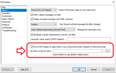

Oh, well, while I have your attention, I've always wondered why when I get something from Amazon and click to open the website, it opens in the PP browser despite being set to open in the browser. My workaround is to 'open in new window'. I just wondered if there is a way to make it open in my external browser. I found some information with search but not a solution. That's it.

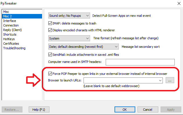

Windance wrote: Mon Jun 12, 2023 11:30 pm .... I just wondered if there is a way to make it open in my external browser....
Under the main menu settings: "Tools" > "PPtweak..." > "Misc 2" page - do you have the settings as circled in the screen-shot below (works for me, as far as what your wanting to do - should use what you have set as your Windows [default] browser):
Main Menu: Tools/PPtweaker/Misc 2
Oh and always keep in mind Windance -- do not hesitate to ask whenever you might have any questions.... (it sounds like this has perhaps been an issue for you, while using a "work-around", for some time now :-k)

Yes, as mjs stated, these are unicode characters; and they appear as question marks because POP Peeper v5 doesn't support them (it will be supported in v6).
Unicode support may come as a mixed blessing in regards to this. Let's take this subject of yours for example:
If you remove all the question marks, you get:
Is your insurance policy working as hard as you?
(that '?' at the end is probably an actual question mark)
What the spammers are doing is inserting unicode characters into the text, but the unicode characters are invisible to a human reading the text (there are lots of unicode characters that aren't intended to be visible). The purpose of doing this is to make it harder for spam filters to process the text; e.g. creating a simple filter to detect "insurance" won't work, because it's got so many other characters embedded in the word "insurance".
The reason I mentioned unicode support will be a mixed blessing -- right now, because PP does *not* support unicode, you'll see the ??? instead of unicode. Personally, that's all I need to know that the message is spam and I Junk it without a second thought. That will be a thing of the past in v6. However, I would like to create a custom filter that tries to detect this kind of spam, so we'll see how it goes.

Mjs, to answer you, I do have the 'Tools" > "PPtweak..." > "Misc 2" set to force to external system default browser. It's always email from Amazon and maybe one other. Just in case, I tried changing my system default to Chrome (from Chrome based Brave) and even tried putting the path to Chrome in. No luck, Amazon mail will open in the PP browser. Wondering, I tried 'open in another' window and it opened my system default browser, good enough. Just curious why Amazon.

Rule Wizard may not be too helpful in these types of email because the insertion of the invisible unicode characters could be random. For example, in the last email it could be "i?ns?ura?nc?e" but in the next email it could be "insuranc?e". This can be addressed using regex (see some of the pre-included "Pills" rules for examples [not the 'generic' one]) -- but regex can be extremely complicated and unless you're already a pro at regex, I would advise against creating such rules. So my advice is just to mark them as Junk and move on.
As for links not opening in an external browser -- some heavily scripted emails may do this. Eventually, POP Peeper will use a different HTML renderer and that may fix these types of problems. In the meantime, instead of right-click/open-in-new-window, you may try holding... ummm... shift? or ctrl? (brainfart), and that should have the same effect, so whatever's easier.
I think ctrl opens a new tab and shift opens a new window, so you want shift-click. probably.
