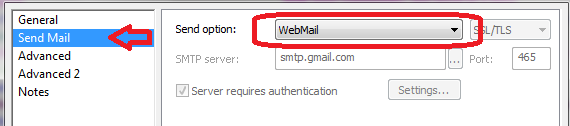

Please take a look at what this specific accounts "Send option" is set at in the "Send Mail" interface.
Edit the account and select "Send Mail" and post in this topic what option you have for the "Send option" setting (as circled in the screen-shot).
Send Option setting.png (9.8 KiB) Viewed 7390 times
Is the setting "Webmail" or "SMTP"?
And you are in fact using POP Peeper to compose & send these messages, right?
Addendum: (I would add, it now crosses my mind that perhaps this is where there may be some confusion in regards to the last question -- the "Sent" messages that are viewed in the "Sent Mail Viewer" of POP Peeper [and reside in PP's account sent folders] will only be messages that are sent using POP Peeper to send them as this is the distinct purpose of the PP "Sent Mail Viewer". As opposed to messages that are sent via other methods i.e. via Thunderbird or Yahoo etc., that will not show up in POP Peepers "Sent Mail Viewer" Interface.)

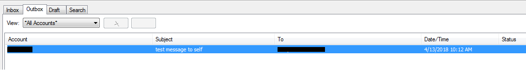

Ok, I have an experiment for you:
1) Temporarily disable POP Peeper's Auto-check process so that it doesn't prematurely send your (upcoming) test message:
- On the main window, click the green button on the bottom-right; it will turn red to indicate auto-check is disabled
2) Compose a new test message to yourself
3) Use "Send Later" instead of "Send"
-> "Send later" may be on your toolbar; but if not, it's under the "File" menu
4) Select the "Outbox" folder in PP to make sure that your message appears there
5) Use Windows Explorer and verify that the file exists in the Drafts folder; e.g.
C:\Users\[USERNAME]\AppData\Roaming\POP Peeper\[ACCOUNTNAME]\Outbox\
** does the file exist? (check the timestamp to make sure that it's brand new; theoretically, it *should* be the only file, but let us know if there are other files present in this folder)
6) Go back to PP and open the message from the Outbox folder
7) Now Send the message and wait for PP to successfully send the message
8) Go back to WinExplorer
** verify that the file no longer exists in the "Outbox" folder
9) Go up a folder and then into the "Sent" folder
10) Sort by the "date modified" column
** verify that there's a new file here representing your sent message
11) Re-enable Auto-check in POP Peeper by pressing the now-red button on the bottom right (it will return green)
The items marked by ** are where I'd like you to reply back with feedback; ie. did each one fail or succeed expectations?

It appeared in the outbox as an.emx file. when sent it left the outbox and appeared in the sent folder. I have noticed now that some emails in some accounts are being saved in sent. Don't know why that would be as have not made any changes.

As to your comments regarding the steps taken to do this "test" in regards to using a GUI to see the message in the Outbox this is presumably one of the steps you took for the "test": "6) Go back to PP and open the message from the Outbox folder".
To clarify, messages that are held in the "outbox" (for one reason or another) can be observed here (in the main PP interface):
The message resides in the PP Outbox because the "test" message was using the "Send Later" option [Notice step: 3) Use "Send Later" instead of "Send"] in the "test" instructions. Also in the event that an error occurs when sending a message then the message will end up in the PP Outbox as well instead of getting successfully sent.

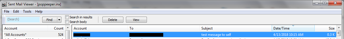

Once messages are successfully sent of course as you know the sent message can be observed in the "Send Mail Viewer" window ("View">"Mailbox">"Sent" or clicking on the "View Sent" button on the toolbar if you are including the button in your PP setup) as such:
Click on image to enlarge for better visibility (use browser back-arrow to return to forum topic)
Does this clarify your suggestion regarding the use of a GUI?

lakrsrool mentioned using SMV, although I'm not sure that you've mentioned it yourself so I don't know if you have it or whether you specifically prefer using Windows Explorer.
Regardless, you're using the terms "outbox" and "sent" interchangeably and they are not the same thing -- 'Outbox' is for pending messages; 'Sent' is for successfully sent. (I'm sure it's just a typo and I wouldn't even mention it except that there *is* a way to get to the 'Sent' folder, but not the 'Outbox' folder)
If you really meant that you want to access the 'sent' folder easily then select an account and then:
main menu: View / Explore -> Sent folder
