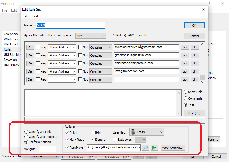

Example screen-shot (referencing "actions" settings available - including the optional "Delete" action you asked about):
Note all of the actions that can be assigned to a specific &quot;Rule Set&quot; (in this case SPAM messages AntiJunk rule).  <br />(FYI: Clicking on the image will enlarge the screen-shot for improved readability - use the browser back-arrow to return to the topic if you do this)
Note all of the actions that can be assigned to a specific "Rule Set" (in this case SPAM messages AntiJunk rule).

If you're confident that PP is evaluating your messages correctly you can set PP to delete all messages it considered junk instead of just applying it to individual rules/filters.
1) From POP Peeper's main menu, select Tools / AntiJunk -> Settings
2) Select the "Actions" page
3) In the "Actions if Junk" section, tick the "delete" checkbox
There are other relevant settings on this page that you may find useful. Specifically, the "delete if junk and score is at least" value. If you bump this up (e.g. to '2'), you decrease the odds of deleting a legitimate mail, but also decrease the chance of deleting Junk.
