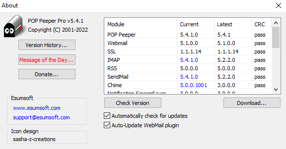

5.4.1 ; so far so good.

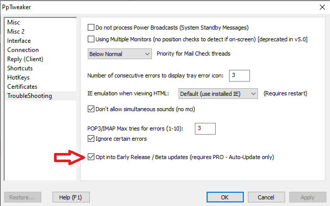

You can opt into the early release (beta channel) from the main menu by going to: "Tools" > "PPtweaker..." > "TroubleShooting" then check the "Opt into early release / beta updates" box (at the bottom of the Interface) to enable this option. (Note: this optional setting is available for PRO users only)

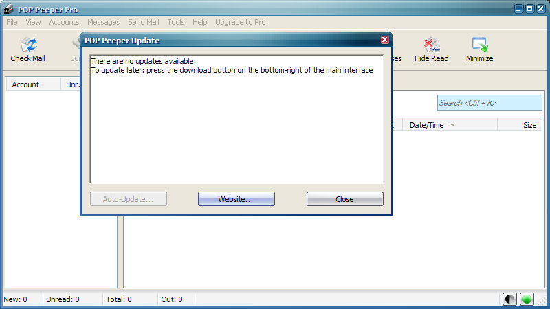

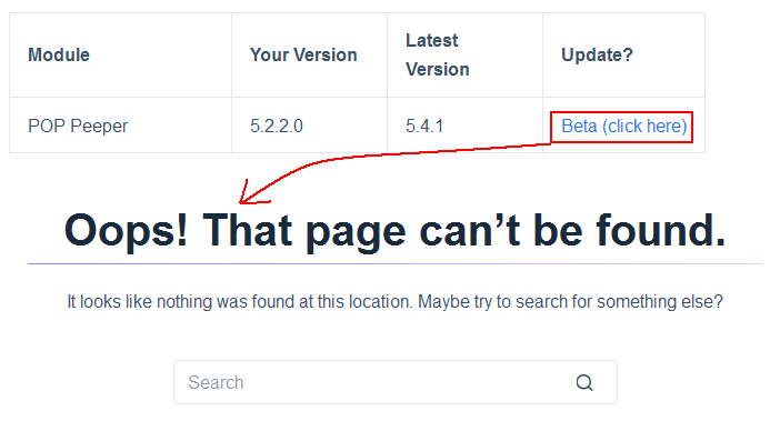

I still don't know how to download version 5.4.1?
  • I installed version 5.2.2 Pro
  • I have enabled the Opt Into Early Release in the settings
  • After restarting the program, I choose Help > About POP Peeper... > Check Version
  • I click Download and info appears that no available updates
If I click the Website button ... this is the link to version 5.4.1 but after clicking it is info that the page was not found:

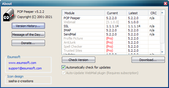

Re: Oauth2 for POP - Gmail recent change
Check to make sure you (still) have this checked:
as you're not getting the bolded part of the Interface (as displayed below) like you should have (it's missing in the screen-shot you posted):
your screen-shot is missing the bolded line.png (6.11 KiB) Viewed 13159 times
Also make sure you have the "Automatically check for updates" setting checked (enabled) in "Help">"About":
... although this shouldn't be necessary to do a "Check Version" successfully.
If you found that the "Opt into early release..." setting was not enabled (checked) as illustrated in the first screen-shot even though you are certain you had enabled this option then perhaps your setting changes are not remaining "saved" - if this is the case then:
Please post where you have installed POP Peeper - to find this, go to (from the main menu) "Tools" > "Options" > "Storage" (this information is at the top of the "Storage" page).
Refer specifically to the "Data path"; if that path includes "C:\Program Files (x86)\" or "C:\Program Files\" then you will need to move the POP Peeper files in as much as POP Peeper does not have access to write to (update) these files (due to Windows UAC, if these paths are used).
You will find detailed instructions on how to do this including your available options in this FAQ:
https://www.esumsoft.com/pop-peeper/faq/?q=DataPath
Please get back to us with any questions you may have or if you continue to experience problems.

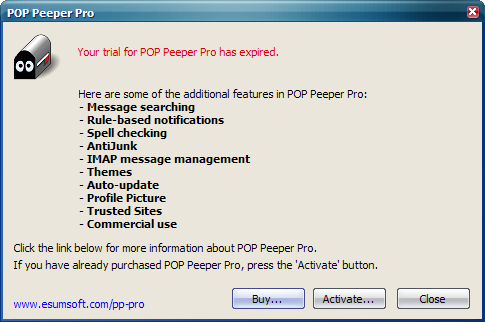

I uninstalled the program and installed it again, but now I do not have the Pro version, but the regular one and a window appears that the test version has expired:
How do I uninstall the program completely so that I can use the 30-day Pro version ??? Something is left in the Windows registry?

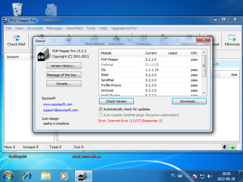

I also tried Win7 SP1 Ultimate and got Internet Error:
To solve this problem I had to enable TLS 1.1 and 1.2 in internet settings but still no access to 5.4.1 version :x :x
You need to have a registered Pro *license*, not just have pro installed (even if still in trial). I've added this notation for the post-v5.4.1 release. I've also grayed out the option if it's not available (this capability wasn't originally available since there hadn't otherwise been a need for PPtweaker to know that kind of information; but I had subsequently added this capability for another reason, so it's easy enough to do it now).
But, barring some unforeseen incident, v5.4.1 is planned to be publicly released this week.
