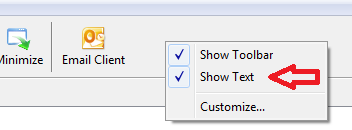

But if I might ask, how do we get smaller icons in the toolbar? They're too big for my eyes now, which seems paradoxical <lol>. But what can I say ... <sigh>. Though the icons seem to be the same size as previous versions, there is so much more to do that the extra icons added now make this toolbar fill the entire width of the screen and are too daunting a size for me. Or if there isn't an option to change to a smaller size (common in this type of toolbar in other apps), that we can request this for future versions (?).

In regards to "smaller icons in the toolbar", I am personally not aware of a way to change this (other than what I've mentioned below). Sometime tomorrow Jeff will be reviewing the board and be able to perhaps add to this.
One thing that will reduce the size of the Toolbar Icons (buttons) is if you remove the "text" from the Toolbar which will result in smaller button icons (as illustrated below). The icons are considerably smaller without text and therefore take up less room on the toolbar (as you can see in this to scale comparison):

Changing this setting is done with a right-click in an empty area of toolbar:
Check or uncheck to enable/disable text
Disable or Enable Text on Toolbar Buttons changes size of Toolbar buttons.png (5.88 KiB) Viewed 6294 times
And of course you can either remove/add Toolbar icons as needed (using "Customize", see image above) or you can also remove the Toolbar altogether and just use the Menu bar. :idea:

But, otherwise, lakrsrool's suggestion of removing the text is the only other way to shrink the toolbar buttons; or remove unnecessary buttons.
