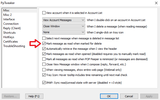

I thought about commenting on an alternate scenario that would avoid this undesired behavior of deleted messages getting "hidden" and still be able to "Hide" read messages in the PP In-box (if that is desired) but decided not to in order to avoid confusion at the time.
But now that the desired results have been attained -- I might as well point out a way to go ahead and hide read messages but not have the potential unwanted side-effect behavior of messages flagged for deletion to immediately (get hidden) disappear (but instead get removed later on the next Mail Check which was the desired behavior in this case).
That would be to go to "Tools" > "PPtweaker" and uncheck (disable) the (default enabled) setting pointed out in the screen-shot:
Uncheck (disable) this (default) option to avoid deletions disappearing at point of deletion and still be able to use 'hide' read messages function.
By unchecking (disabling) this option you can then utilize the "Hide read messages" feature and at the same time not have newly "Deleted" messages get hidden (since the deleted messages will remain unread) hence not produce the impression messages are getting removed immediately (which are actually just getting hidden, when messages are marked for deletion, with this option pointed out in the screen-shot checked [enabled] in combination with the "Hide read messages" option enabled as well).
I'm mentioning this for the benefit for anyone who might prefer to "Hide" read messages in their PP Inbox but want to avoid this "side-effect" so to speak behavior when this default setting in the screen-shot above is used (enabled). (after reading this convoluted explanation you can probably understand why my first inclination was to skip this alternate scenario. :lol:)
