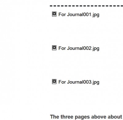

Some emails with pictures do not view only text of picture. See attached...
Any solution?

Which one of the Email Services is this occurring on? (i.e. Outlook.com, Gmail, Yahoo etc. etc.)
• AOL
Are the images getting displayed when reading the message on the web (when logged into the Email Service using your browser)?
• Yes
What version of POP Peeper are you using?
• POP Peeper Pro v5.1.2

River -- assuming that the images aren't being intentionally blocked as per mjs's last screenshot, can you provide a sample message that exhibits this issue? To do so:
1) View the message in POP Peeper
2) From the menu, select File / Save message as
3) Save it to a file
4) Send that file as an attachment to (support at esumsoft dot com), and please include a link to this forum topic for reference.
The sample email you provide will contain personal information (e.g. your email address), so do not post it to the forum.

Re: Can't view embedded pictures in email?
The pictures displayed for me, which may indicate that you have some relevant settings not setup correctly.
Here's a URL to one of the images:
https://files.constantcontact.com/654d25d0101/3235c3f7-a55d-4fca-8705-18662b09a2ab.jpg
First, try opening that URL in Internet Explorer (PP uses IE-based controls to display HTML; do not use Edge, it must be IE). I suspect that it won't display. If it doesn't display:
1) From IE's menu, select Tools / Internet Options (typing "internet options" into the start menu will open the same thing)
2) Go to the "advanced" page
3) Scroll to the bottom and make sure that the following are enabled:
- Use TLS 1.0
- Use TLS 1.1
- Use TLS 1.2
(TLS 1.3 isn't necessary, do not enable SSL 3.0 if it's disabled)
If you changed anything, save it and then try reloading the image in IE again and see if it works. If so, try PP again -- if it still doesn't show the images, try exiting and restarting PP.
There are other options in IE that may need to be adjusted, but that's the most likely one; so try that first and we'll go from there.
I tried disabling TLS 1.2, and IE could no longer show the image, so "Use TLS 1.2" must be enabled.

Here are my ie11 settings you mentioned:
The pic url displays in firefox and ie11 displays an error message:
For some reason, I thought you had win10 (looks at screenshot to deduce version, "yeah, that's win10..." #-o ). Now I'm paranoid I've forgotten what all those old OS's look like -- Win7, right? I wouldn't think that win7 would have a TLS issue, but it's certainly possible since it's out of support now. I know Vista doesn't support the later TLS revisions very well.
So, the other thing you can try is back on the "advanced" page of Internet Options and press the "reset..." button. After you reset, make sure that TLS 1.2 is still enabled and also go to the "Connections" page / LAN settings and make sure it's using "automatically detect settings" (ie. sometimes a bad proxy can cause this problem -- you can check this before "resetting" if you want).

Yes...W7
Resetting IE11 didn't help and "automatically detect settings" is checked.
I updated my Win7 VM to IE11 this morning and I can confirm that it looks like the website uses technology that isn't compatible with Win7's TLS.
I would like to provide an alternative HTML renderer, but other priorities have kept me busy from that.
In the meantime, since I don't remember seeing a "view online" link in that newsletter, another alternative is to use the File / "Open message in client", but you'll need to have Thunderbird or a similar client installed for that to work.
Or, update to Win10 if just for security reasons :-|
