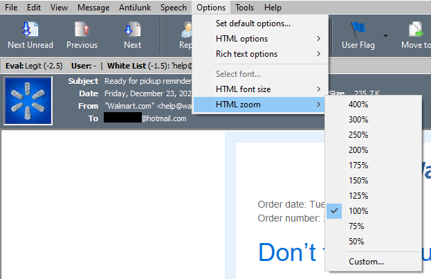

I have been running a paid copy of Pop Peeper Pro for over a year and it auto with auto update on and I love it for its simplicity and effectiveness for all my email.
In trying to fix the problem described below, I have uninstalled and re-installed the program several times, but the problem does not go away.
I have read old posts here that mention enabling zoom in Internet Explorer, but my IE has zoom enabled.
The problem is as follows:
While reading any message, if I click on 'Options' from the menu and move the cursor over 'HTML Zoom' without even clicking on it, an error message pops up and I'm unable to set HTML Zoom. The pop-up does not say what the error is about. Please see attachment.
I have never tried using HTML Zoom before, it's possible this problem has always been there, but hidden.
Any comments as to other things to try for this problem would be greatly appreciated!

Re: Revisited topic: Still no solution for HTML Zoom error
I have actually never used that option myself - that said, what is supposed to happen on just "hover" is the following:
Thanks, mjs.
I tried using this option just recently because some of the email I am receiving has a very small font and it's difficult to read.
This option does not even show me the different levels of zoom, as soon as the mouse pointer goes over HTML Zoom, the error window pops up. The only way I can do anything else in my computer is by clicking on the error pop up, then it goes away.
To be clear, any dialog or popup message of any kind would be expected to typically have some kind of explanation.
This error is what I would call an "anomaly", that is, an unanticipated outcome of some kind that might (as in this case) generate a prompt that is basically "undefined".
When something that is essentially unanticipated (that is not necessarily accounted for) by POP Peeper's code then this type of prompt might occur. To explain in another way, basically an error of some kind that is not necessarily accounted for by the POP Peeper program (not all outcomes can ever be fully accounted for of course).
Let me be clear, these are my descriptions of the situation and as such is not necessarily how it might be characterized by others (it's just my attempt at explaining this kind of outcome that can occur in any software in general).
From my personal perspective the actual cause can be due to many things including program or possibly data "corruption" of some kind, an unanticipated sequence of events in the code (of which this prompt is used for in this case, hence working as expected), some extraneous issue involving the interface with the Operating System and/or Network or possibly (but not likely) simply a software "bug", etc etc.
Btw, just as a matter of record (based on the way the topic is described as "revisited"), there doesn't appear to be any other topic previously posted on this subject (at least not so under this username) in the forum (just an observation
With that out of the way - in order to look into this further in more detail, it would be helpful if we could get some answers to questions.
I will list some of these questions (that I can think of) in my next post in order to more fully focus the context of our follow-up on just the questions at hand - please kindly answer each question to the fullest extent possible -- thank you very much in advance for taking your time to do this.

Just in case someone else comes along with the same problem, I thought I'd add a conclusion and an alternative "solution":
I believe that grevier resolved the solution with the following steps:
1) Open "internet options" in the Windows Control Panel (open the Windows Start menu and type that for easy access)
2) Select the "Advanced" tab
3) Press the "Reset" button and reset everything
I'm glad that worked. As I was reading this topic, another solution came to mind --
You can use shortcuts to perform the zoom operation. If you hover your mouse over the message body (while viewing HTML), you can use Ctrl+MouseWheel to zoom in/out. Alternatively, click in the HTML body somewhere (to set focus to the "html window") and then use Ctrl+(+) and Ctrl+(-) to zoom in/out. Ctrl+0 will reset to 100% zoom. It's possible that doing this would fix the problem with the "html zoom" menu, too.
