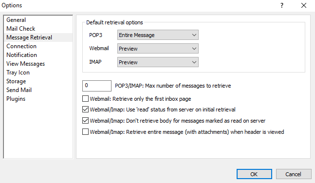

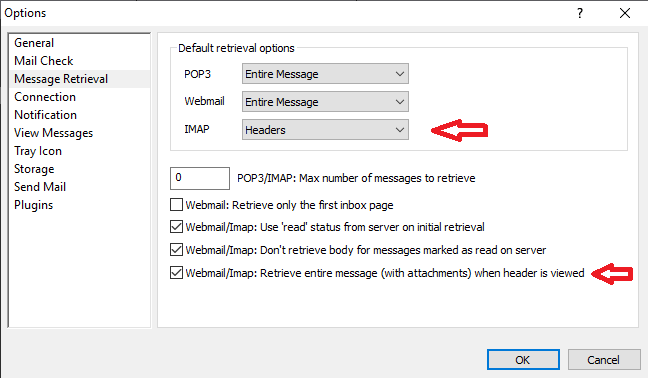

Note that "Message Retrieval" settings can be overridden per-account: by doing an edit on the account and going to the 'advanced' page - you can check to see if your settings specific to the account might be overriding your global "Message Retrieval" settings in a way that would impact your issue.
Based on your settings it would appear to me if another Email Service application is reading your messages (prior to getting retrieved by POP Peeper) then those messages may continue to not get retrieved by POP Peeper (based on your "Message Retrieval" settings, specific to the 2nd checked option toward the bottom of the settings page) . With that in mind, when you check at the POP Peeper "source" Email Service (i.e. logging into the account on the web) are the messages that fail to get retrieved by POP Peeper marked "read" or marked "unread" (at the source)?
I'm not sure myself what exactly might be causing your issue (other than possibly the above) - I'll post what my "Message Retrieval" settings are FWIW and suggest, if you will, settings you could try just to see if it might help your situation.
My "Message Retrieval" settings: Suggested settings you might consider trying (that is, if the messages that fail to get retrieved by POP Peeper show up as "unread" in the relevant Email Service that is used to populate the POP Peeper Inbox - changes pointed out. On the other hand if the missing messages in POP Peeper are marked as "read" then you might consider disabling the option discussed above in regards to the 2nd checked option toward the bottom of the interface -- which, btw, would then match my settings): On the other hand, you may prefer waiting on a reply from Jeff in regards to the issue you have.
Of course if you do try changing the "Message Retrieval" settings - please let us know, if you will, what the change was and what you get as a result of the change.

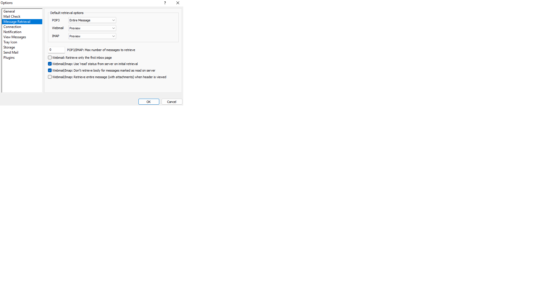

I only use poppeeper to retrieve emails on one computer, so no other email agg programs used. Also the emails not retrieved by poppeeper were not already read when I discovered them in yahoo. Finally, I set my Mail Retrieval settings like yours but the behavior persists (no emails with attachments retrieved by poppeeper).

Also just upgraded to poppeeper 5.4.1.0. It seems that no combination of those webmail boxes checked nor dropdowns for IMAP in Message Retrieval result in retrieving my unread emails with attachments from yahoo into poppeeper.

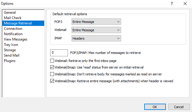

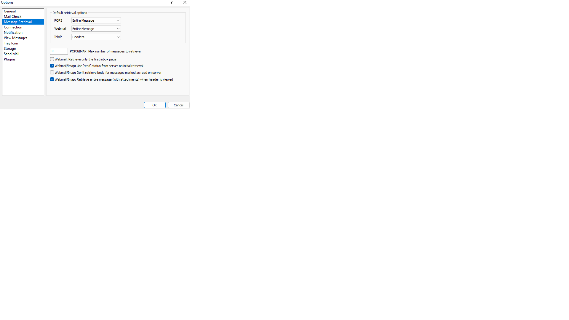

Update....everything seems to be right as rain this morning. Didn't do anything other than make my Message Retrieval boxes look like mjs's. I didn't delete and recreate my account either. Looks to be working just fine this morning for expected emails with attachments hitting poppeeper. Thank you so much for your help!!!!

Do you remember what you changed in POP Peeper settings? None of the basic settings should prevent PP from displaying the headers in the message list (except if using "number of messages", but you'd notice that for all your messages, not just ones with an attachment; or if you applied a limit to the number of messages; or.....
scratch that comment), so I'm just curious.
Regardless, I'm glad to hear it's working again.
