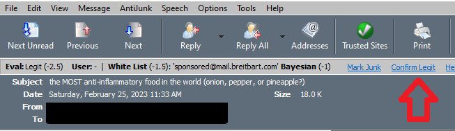

To confirm - is what you're discussing the "Mark Legit" option when reading messages (as pointed out in the screen-shot below)?
Mark Legit.png (1.96 KiB) Viewed 10562 times
If so, then after clicking on "Mark Legit" (assuming you have not changed the default POP Peeper Inbox format and therefore still use the "Junk Evaluation" column) do you observe in the POP Peeper Inbox what is circled in the screen-shot below for the same (specific) message you did a "Mark Legit" on?
If so, you should not have to do a "Mark Legit" for that specific email address again (keeping in mind that this only applies to that very specific email address).
To confirm the problem - so then you are saying that after marking a specific message as Legit (after clicking on "Mark Legit") the next time you view that same (specific) message you will still see the "Mark Legit" as displayed in the first screen-shot posted above? (I ask, because after marking a specific email address as Legit then the "Mark Legit" option should no longer be displayed when reading a message for that same specific email address) - The "Mark Legit" setting will only apply to the same specific Email Address you have marked as Legit, so make sure other messages you are reading (that you might expect to be Legit) are also using that identical email address.

In order to clarify your issue as to whether the issue is that a "Confirm Legit" option displays after clicking on the "Mark Legit" option (since you have now directly referenced the "Confirm Legit" option) or that you are unable to successfully mark a message as Legit using the "Mark Legit" option....

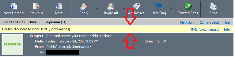

Question: are your messages displaying the way you want (expect) them to display (including images, if that's your goal) and you are not getting the banner that requires a double-click to display images you want to see (screen-shot example of banner getting displayed below - note: the banner will stop getting displayed for the specific email address being read by clicking on the "Confirm Legit" in this case)?
Is your concern that you continue to get this banner (even after doing a "Mark Legit")?  Or is the banner not your issue?
If your concern has nothing to do with the banner (that is you are not getting the above banner after using the "Mark Legit" option) so that you have no issues with how the messages display, then is it accurate to say your only concern is that the "Confirm Legit" in your "evaluation bar" continues to display, even when you have clicked on the "Mark Legit" (to display images)? (see screen-shot example below)
Is your issue only that the "Confirm Legit" continues to display even without the banner?
If this is the case, then I wouldn't be concerned as long as your (marked as Legit) messages are displaying without a banner (that is the message has been marked as Legit in this case) thus images are not getting blocked using a specific email address you have marked as trustworthy.
Note: regardless of the above, if you do click on the "Confirm Legit" then that option should not display the next time you read messages sent to you from that specific email address.
I'm assuming it is just the "Confirm Legit" option that concerns you, thus there is not an issue with getting HTML to display for messages you get from "trusted" email addresses.... if otherwise, then we can address that as needed.

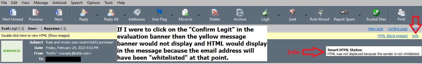

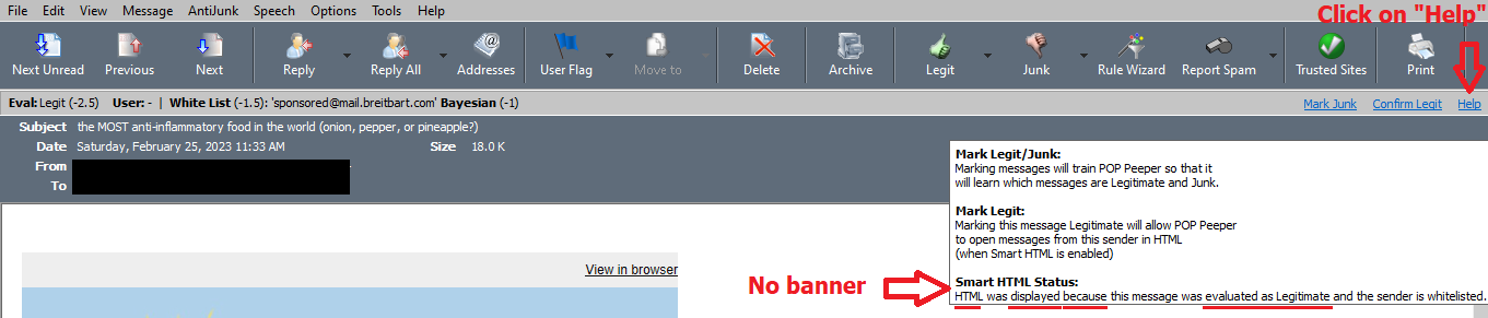

More information that might help (taking the last two screen-shots posted above for context):
1) Message is not displaying HTML (images) therefore the banner is present because the email address is not "whitelisted" (refer to comments embedded in screen-shots for details).
2) Message is displaying HTML (images) so banner is not present because the email address is "whitelisted" (hence evaluated as "Legitimate").
Click on either image to enlarge for more detail (use browser back-arrow to return to forum topic)

This is my understanding as far as answering your question - "why confirm ?": The presence of the "Confirm Legit" is to indicate that the system has in fact evaluated the message as "Legit" so you're simply confirming this status by clicking on this option (an already obvious concept). To elaborate on the concept behind this however (i.e. the crux of the matter, so to speak) is that this approach is expected to help get more users to "train" POP Peeper which messages are Legit even if a message has already been evaluated as Legit.
To clarify, the more that messages are marked either "Legit" or "Junk" basically helps "train" POP Peeper to better learn which messages are to be considered either "Legitimate" or "Junk" (hence improving accuracy in this regard) - You might notice (in the 2nd screen-shot) I had previously pointed out the "Help" option in the evaluation banner in the event the "Confirm Legit" option is present in that same banner (which I might add, is when you will get the "Help" option displayed when and where you will find the "Confirm Legit" option if present in that same banner). That said, my point was at that time to address the displaying of HTML in regards to whether the banner is present, however to your current question - refer to the "Mark Legit/Junk" comments in that same screen-shot (at the top of the "Help" explanation) which would apply to your current question - where it states that: "Marking messages will train POP Peeper so that it will learn which messages are Legitimate and Junk" (which, again, is more specific to your current query).
More to the point in regards to the "training" of POP Peeper concerning "Legit" versus "Junk" messages - the "Confirm Legit" option is what ultimately provides a way to enhance (for lack of a better word) the manner in which POP Peeper "learns" how to evaluate the legitimacy of messages in accordance with a Bayesian evaluation score (if you will).
