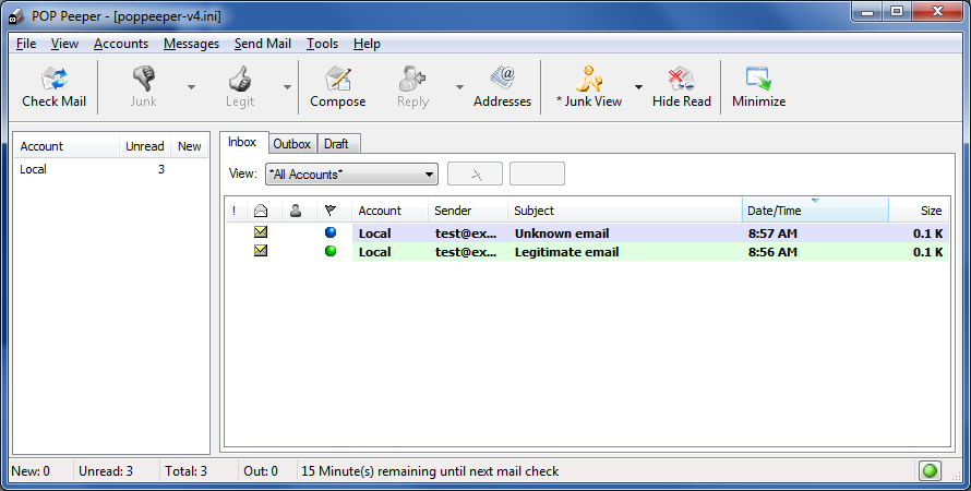

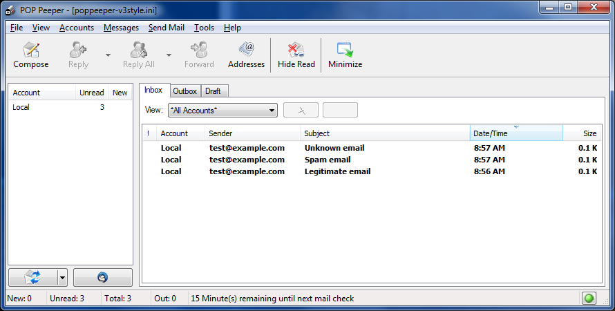

View the before (v4 default) and after (v4 modified) images to see the differences that can be made in v4.
Mark as Junk and Legitimate buttons
Messages are hidden/filtered by AntiJunk
Messages have a green/blue/red background
Messages are not displayed in HTML by default
Check Mail / Email client buttons
New columns in the Message List
Add/Edit/Delete Account buttons have been removed
Reply-all and Forward toolbar buttons removed
