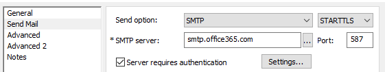

For example:
Do you currently have the following settings (for "Send mail"):
Suggested settings
Suggested settings
suggested settings.png (4.54 KiB) Viewed 61698 times

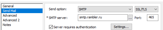

Or do you have these settings:
Try to use in POP Peeper
try settings for PP.png (4.61 KiB) Viewed 61698 times
If you currently have (are using) the former top (first example) then try the second example of settings (just above) in POP Peeper to see if this helps with sending messages.

I agree the settings you are using:
Incoming Server: imap.rambler.ru, IMAP port: 993, IMAP security: SSL / TLS
Outgoing "Send mail" SMTP Server: smtp.rambler.ru, SMTP port: 465, SMTP security: SSL / TLS
Are expected to work on Thunderbird, and if so should also work on POP Peeper.
That said, it appears the "Send mail" settings aren't working as expected (for some reason). :?

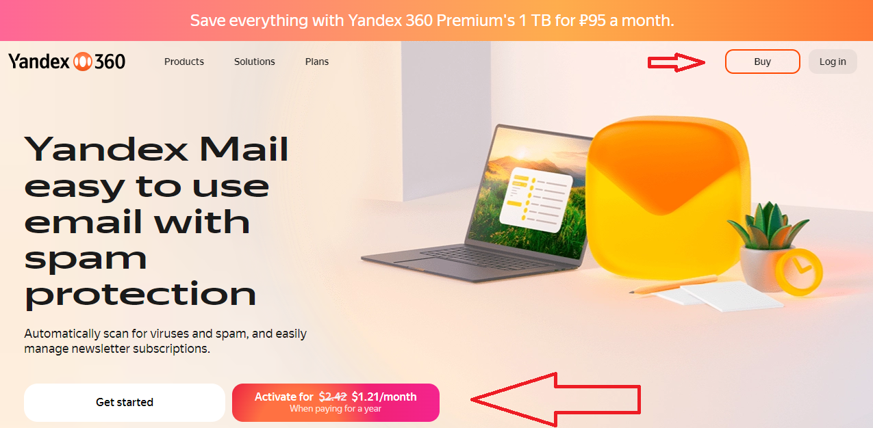

Just discovered this on the web: How to Get a Free Yandex.Mail Account, (it's probably dated, but I'll check it out and report back)
Re: rambler.ru
Tried the link out and got this:
Oh well, it was worth a try :)
It looks like I was right, the opportunity for a free account has apparently passed (probably within the last 8-10 months or so at the outset :cry:...)
